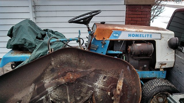

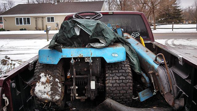

New Allis Homelite in the truck.
Right from the east side of Flint,Mi.
Sorry I didnt post this sooner saved it up about a month ago, been busy with work. If anyone has any manuals they would like to share that would be fantastic.
No attachments except mower deck. Rear lift missing, and (strange), the lift indicator. Good battery, electric lift and the electric pto works. engine has spark, carb cleaned, new blower housing,(rusted at bottom), started painting engine parts, cleaned head, wear looks good in cylinder and sending flywheel to briggs for electronic ignition.

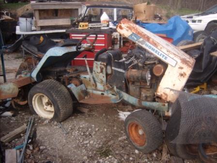

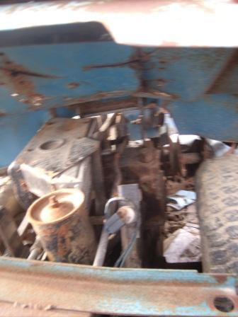

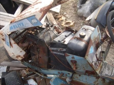

heres the pic of the one i have.
looks like you have a lot more to work with. i bought this one for the parts on it. i have a T15 that is almost all painted and it will be a pulling tractor. but its been sitting for a while. some day this summer when i will have time to get back to it.

What the heck happened to that?
