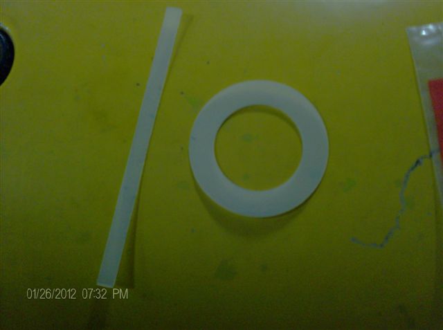

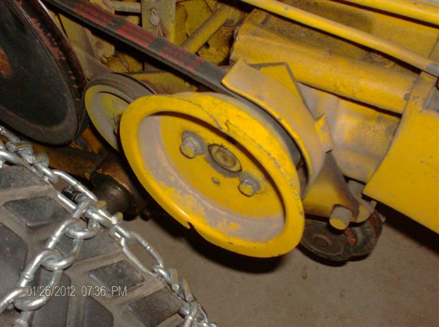

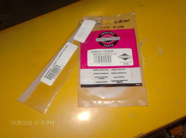

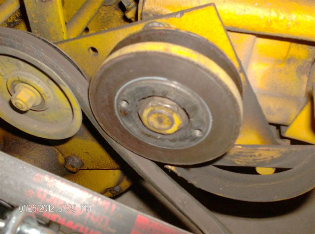

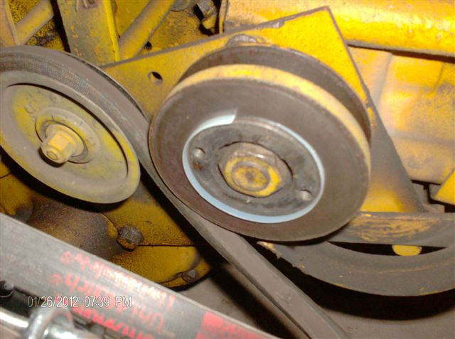

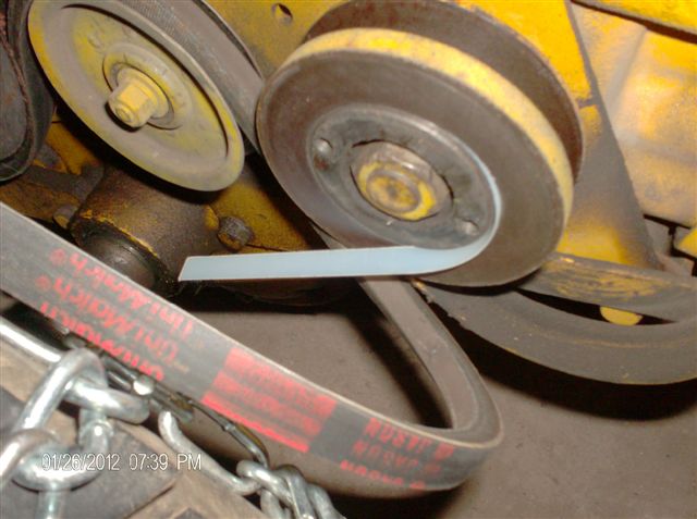

Had some time after supper tonight so I headed out to the shop. Clutch split pulley has been noisy since I bought this tractor. Ordered the bearing strip and thrust washer last week and it came in yesterday. So, tonight I took a half hour to install and silicone lube them. Nice and quiet now. Dave

Makes a big difference, not just quieter but a lot smoother in operation to

what did those little jewels set you back? by far the smoothest clutch they ever made.

Not to bad Phil. $11.02 full retail at the dealer just 10 mins. away from me.

It's amazing just what they do. The first time I had to sort out an issue there, I didn't have those, and didn't realize thy were missing completetly What a headache that was. I'm stocked up on them now =]

That is a bit steep for nylon but the effect is priceless.

Posted - 01/27/2012 :  13:02:45  Show Profile  Visit acb10_64's Homepage Send acb10_64 a Private Message  Reply with Quote
That looks very familiar! Nice Job!
Posted - 01/27/2012 :  13:11:20  Show Profile  Visit B112's Homepage Send B112 a Private Message  Reply with Quote
Looks like that fix is ready for another 40 years. :)

I just ordered two sets of them from my dealer, they were $3.99 each per piece wonder why they are cheaper here. Does it say to use silicone spray on them?

No instructions to use silicone Freddie. I just figured it couldn't hurt. Dave.
