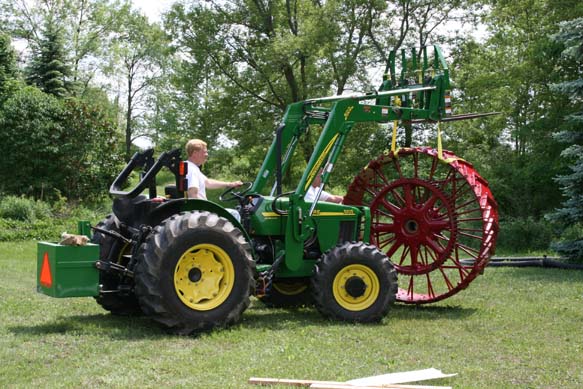

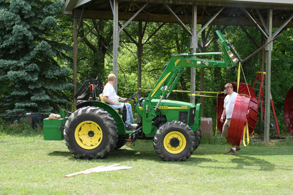

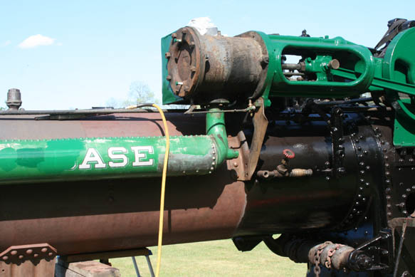

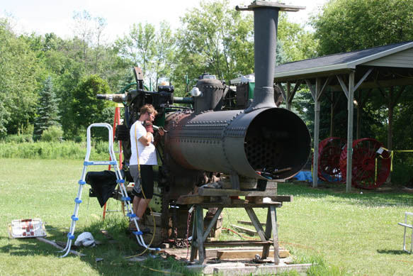

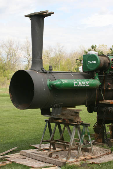

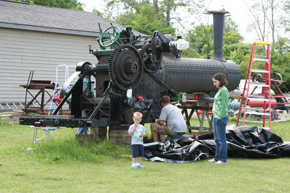

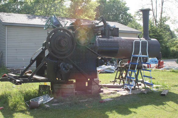

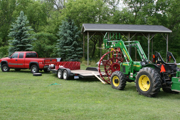

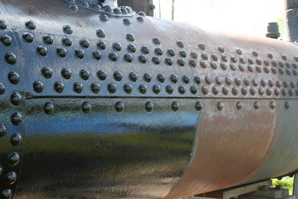

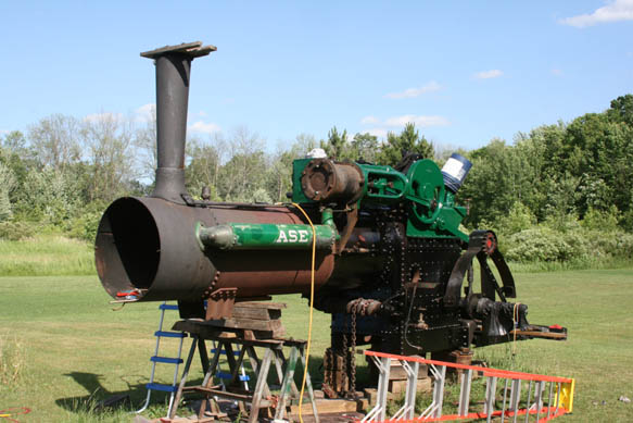

I love watching you guys restore the tractors, taking them from what some would call junk to original condition. Even though it wasn't a restore job, and it certainly isn't a GT, we repainted my dad's Case steam tractor a couple years ago so I thought I'de share a few pics. i think this was right at the limit of our capabilities. My dad's John Deere could not lift the rear wheels, but when my brother and I pushed up on the loader arms it would go up, and then was able to hold it. It was a balancing act. But my brother especially put a lot of time into hammer drilling that cast iron, and it looks great now.
The engine in 2004:
The after:
The process:

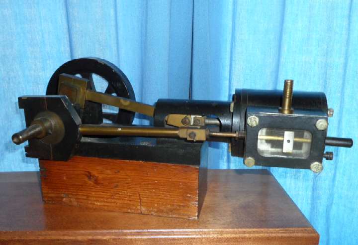

You guys sure have some neat antique machines, thanks for the pics. I built a working double action reiprocating engine in High School. Been a cool converation piece ever since.

That's impressive Jon. Turned out great.

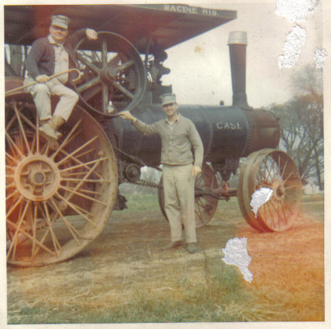

My step dad had three 65HP Case Steam Traction Engines. What HP is yours? It looks to be at least 40 and maybe up to a 65. Hard to tell from pics..
This pic of my Step Dad's Case 65HP was taken in the early 70's.

Byron, right you are, its a 65hp. I love that photo of yours. My brother has a 20hp Advance Universal which is comparable. transportation is by semi only. roughly 15 tons dry. the state just cold pressure tests them 150% their running pressure. ours runs at 150psi so there must be no leaks at 225psi. this must be done every 3 years. also, they look for non-approved welds and general boiler warning flags. i love how everything is large, the rear wheels are nearly 1 ton apiece. we had to take everything slow and extra cautious as Phil said, we couldn't afford an 'oops'...
