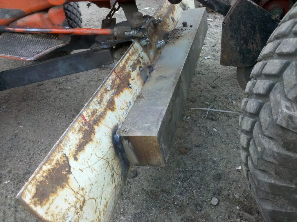

freddie Posted - 09/19/2010 : 18:34:55
heres what i came up with for the weight on the blade.
its 316 sst 3x3 solid bar stock. 140lbs works alot better

olcowhand Posted - 09/18/2010 : 16:33:48
Downforce will affect your traction when hitting high spots, where blade mounted weights won't as bad, but then if you weight your tractor enough, it should take care of most or all of it. I like those weights, and being you won't need them now.........

adamf203 Posted - 09/18/2010 : 15:48:43
Dont the weigths hanging like that to the front interfere with the material that your pushing. Would it make more since to hang them to the rear?

freddie Posted - 09/17/2010 : 18:59:58
thanks cris,
i had to add 100lbs to the blade to get it to cut the way i like.
i'am going to fab a bracket insted of the chain so i can apply down force on the blade. heres a couple pics.
