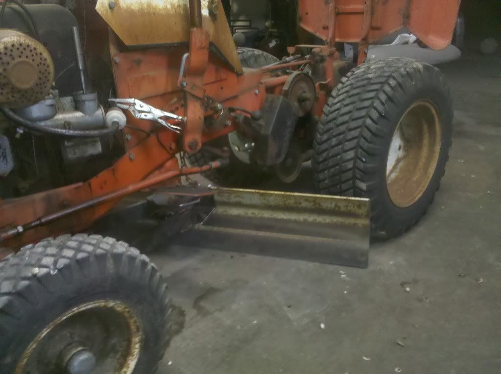

i'am starting to fab up the brackets for this project. this should be easy for an old pro like me. lol. i will have pics on weds.

its made out of 1/4 and 3/8 steel. i dont think it needs the center brackets because of the 3/8 sides on it. will try it . and go from there.

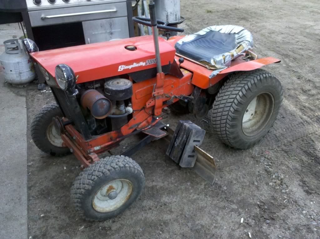

freddie is the blade attached at same place where deck attaches, by the front axle? And how does it tilt? It looks pretty strong.
I am trying to figure out how attachments and hitches work generally. any comments appreciated.
I always wonder if blades, and especially front blades, can cause damage if one hits a solid object like an ugly rock of something. I tend to think that front end area is delicate; and some blades have frame rails that extend to rear axle, which seems stronger, but then I wonder if rear axle damage is possible. I suppose using it with some care would go a long way too. But I think what I really need to do is see some of these devices up close and personal.

GRAY, IT TILTS 25 DEGREES LEFT AND RIGHT. WITH A LOCKING PIN.
AND IT HOOKS UP WERE THE MOWER DECK DOES.
ITS RAINING OUT TODAY, SO IF IT STOPS I WILL GO TRY IT OUT.

I just find it hard to believe that those little "ears" are strong enough to support a blade. I think I have to crawl underneath and really take a look at what's going on under there. Good luck w the test drive.

i have ran into alot of things with the snowblower and mower decks, the ears seem to hold there own. stout little mounts.

those little ears can take a beating ive had the grader on them the mower and the push blade your not going to break them i do wish i had a snoblower mount the to modify for my push blade hey freddie you might want to add those pcs in between the mount tho mine 2 x 1/2 and they put them in for some reason

thanks dan, i wil be adding some cross members to the frame. as i can see that when you run the blade to the left or right there could be some twist.
also the blade will need to have some extra weight added to it. i will take some pics today.
i also moved the location of the lifting chain to the frame, not the blade like they have it.

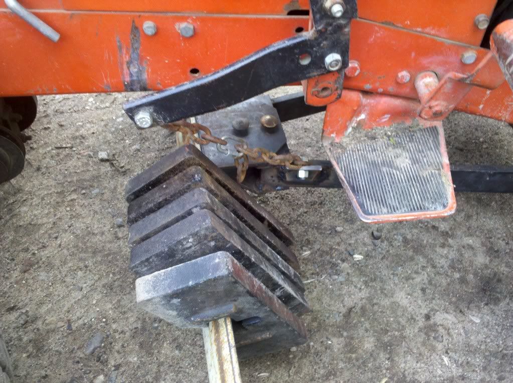

i had to add 100lbs to the blade to get it to cut the way i like.
i'am going to fab a bracket insted of the chain so i can apply down force on the blade. heres a couple pics.
