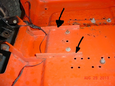

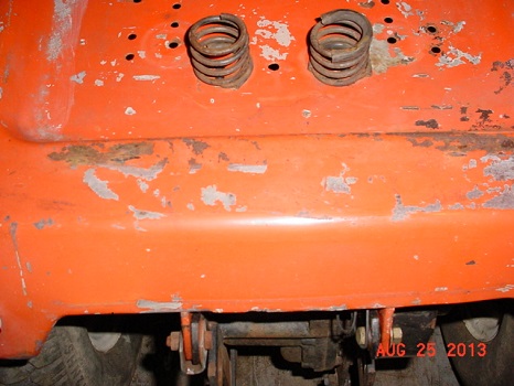

Previous owner on this 712S, lengthened the seat pan braces, thus as old as it is, it doesn't have stress cracks. That's a rare bird with a little foresight.

Agreed! Must not have been his first dance.

That was fine thinking! Got a couple to fix, have to do the same to prevent a repeat.
