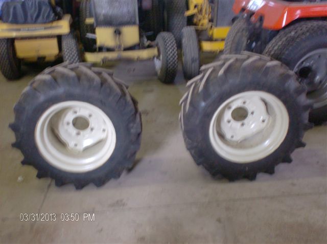

I got a good deal on a set of 23x8.5x12 ag tires on my way home from Florida.Mounted and fluid filled!

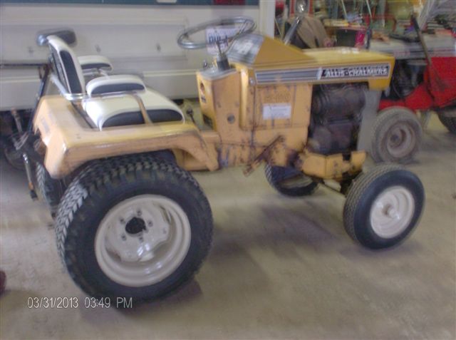

I am trying to put together a plow rig for Daniels plow day in the fall.At first I was just going to put them on my B110, a known good running tractor.

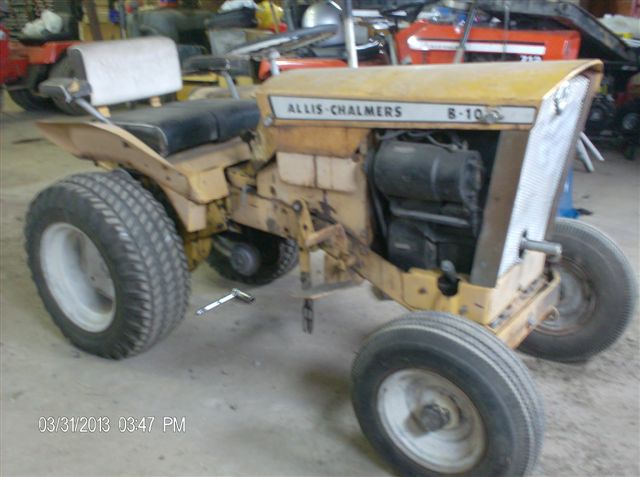

But today as I was moving some things in the shop I had to push this early B10 out of the way. I have had it for several years and not got around to starting it or checking it over. It has a later engine, straight tin with only one side panel missing and seems to be in reasonable condition.

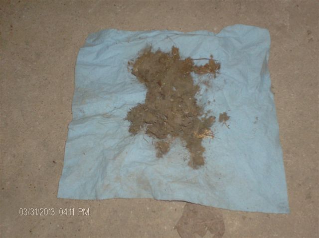

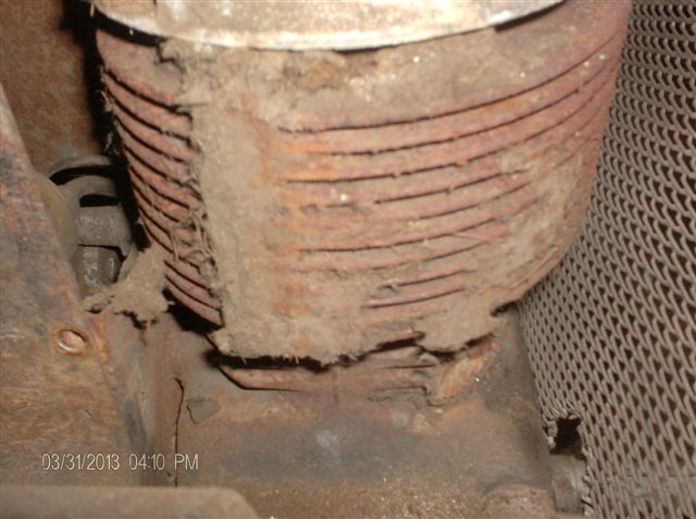

I took off the carb and disassembled it. Very clean inside and emulsion tube came out no problem. Reassembled and reinsatalled it. Checked for spark (nice and strong). Checked and topped up oil. Added a battery and gas and it fired on about third revolution."YAY" Too bad there was not a steady stream of cooling air blowing over the fins.. So, off came the shrouds. Didn't smell at all like a mouse condo but there was something in the head and cylinder fins. Took this off the head.
There was nothing down near the coil but the cylinder fins looked like this.
Pushed the whole thing outside and spent 15 min. with the air blowgun to thoroughly clean out fins, flywheel and engine compartment. Back inside the shop I put it all back together and went to tighten SG belt.

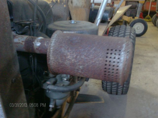

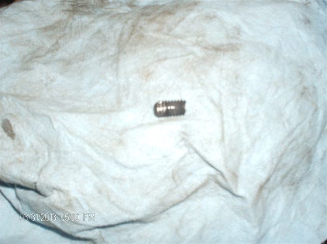

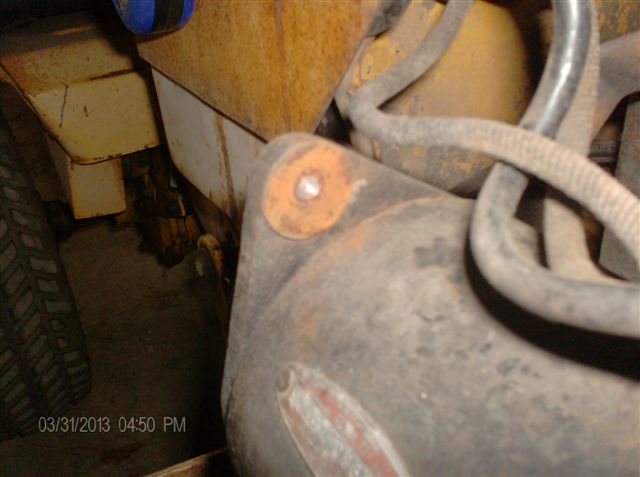

Oh well; had the broken bolt out in a few minutes thanks to MR Vicegrip and Mr Torch!!! Finished tightening belt and fired it up. Runs good with no smoke or noises. Went for a quick run out the driveway. All gears good, tight bevel gearbox and no strange noises. It has a weird muffler on it but it is the quietest Briggs I have ever owned. Will probably keep it but shorten the pipe nipple to move muffler closer to engine.

Phil, hydrolift is on my 2012 (have not ruled it out yet either).712H has BGB problems that I'm not ready to repair yet.It is a nice tractor though so I will get to it eventually.
