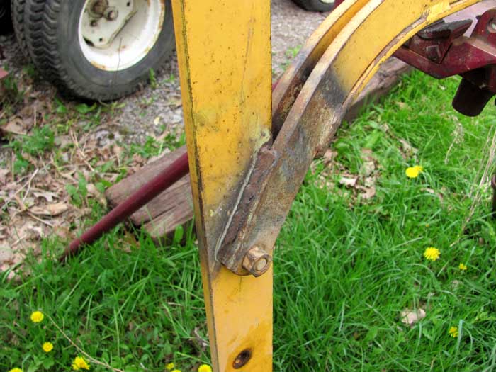

Picked up this Allis plow the other day. The previous owner evidently had the plow set where he liked it as there were welds on both sides where it pivots! After a little cutting and grinding I freed it up. Not having much experience plowing with a foot dragger I decided I would give it a try. Set up in the garage before heading out to the garden. Took a few passes in first gear full throttle, too slow, had to really lean to the land side to keep from losing traction. Second gear full throttle was just a bit too fast. Dropped back to just under three quarter throttle and seemed to be about right. Still had a little traction problem on the land side but did well enough for my trial. Overall, it worked well. I had to stop at the end of the furrows and back up a bit to raise the plow with the armstrong lift even with the front counter weight so I think I will stick to the hydro or electric lifts for plowing!

Curious if you find that the adjustment on the plow moves on it's own? I've noticed mine is very free to move, and figure I'll need to tie it off to keep it from turning when it's vibrating while in use. Perhaps that's what the PO got the welder fired up over?

Josh, the front stayed down and steered good with the weights. I would have liked to of had a few more wheel weights hanging off the landside rear. As far as the adjusting rod. I think I'll be putting a nut behind the clevis so I can lock it down once it is set to the soil conditions that I'm plowing in.
Yup, I like that idea better!
