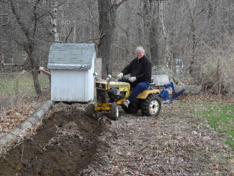

Took half an hour, 3/4 throttle, 2nd gear and the variable at the top plenty of power and traction. Going to set up the coultier next.

Posted - 04/01/2012 :  10:01:27  Show Profile Send skunkhome a Private Message  Reply with Quote
Larry looks like a great breakin. The coulter will really ease the breaking in most soils, however I have seen some so rock hard that they have to remove the coulter all together to just to keep it from rolling the mould board out of the ground. Did you encounter many rocks. I end up running about 1/2 thRottle in second high or third mid. Of course this is in soil that has been in cultivation for four years and has little sod.

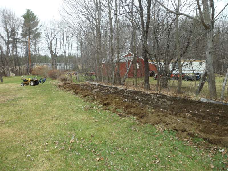

Posted - 04/01/2012 :  13:15:23  Show Profile  Visit larry8200's Homepage Send larry8200 a Private Message  Reply with Quote
A plow day would be great, KY a little far for me, never know though.
If you look, you can see this is an established strip garden, about 70' x 10' the last 3 rows plowed were established turf and would have been easier with the coulter set up correctly. Now it is 70' x 14' The nice new clean plow went easily through all, and picked maybe 4 rocks in the 4"-6" range. Nothing really
I have 2 sets of disks I hope to play with here, but probably not going to get both set up opposed. The biggest problem I see doing a double disk is it will be to long and heavy to lift on the sleeve hitch

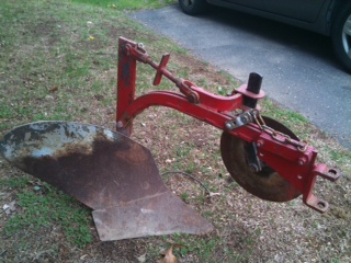

I actually just got back from pennslyvannia this morning picking up a moldboard plow. 2 hr drive, but for $90 I couldnt say no.
Larry's got me jealous, want to go turn some soil now!

Posted - 04/01/2012 :  19:19:21  Show Profile Send skunkhome a Private Message  Reply with Quote
That looks like an original Simplicity too.

adamf203
384 Posts
Posted - 04/01/2012 :  19:53:00  Show Profile  Visit adamf203's Homepage  Send adamf203 an AOL message Send adamf203 a Private Message  Reply with Quote
Phil I believe that it is - it matches the attachment manual I have. It looks like someone painted it at somepoint the wrong color though.

Posted - 04/03/2012 :  06:55:21  Show Profile  Visit cschmidt62's Homepage Send cschmidt62 a Private Message  Reply with Quote
Looks like the coulter is on backwards
Posted - 04/03/2012 :  07:39:02  Show Profile  Visit Talntedmrgreen's Homepage Send Talntedmrgreen a Private Message  Reply with Quote
Yup, and it's gonna want to bend. Better flip that around before breaking ground. I've seen lots of screwy setups on these simple implements =]
Adam, I know you're a bit of a purist...here' sthe manual for the 990204 plow
http://bsintek.basco.com/BriggsDocumentDisplay/default.aspx?filename=heCyEN8aqI6rE3Cvh5kbp796Dq
And here is the proper hitch setup for use on the B-1/725 vs later Landlord/B-series models. Guessing there's a slight alignment difference between the hitches on those machines, or perhaps it's to position the furrow differently for the narrower machines
