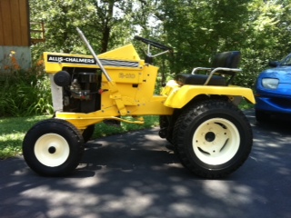

Hello everyone, Last fall I posted pics of my 67 B-110. I paid $200.00 for the non running tractor. I decided to do a complete restoration to ready myself to do my larger Allis model C. All yellow and cream metal surfaces were cleaned using electrolysis then Picklex 20 was applied to store the parts without rusting. I did a final acid wash then used DX-330 to clean prior to painting. I also used epoxy primer in white which is a two part primer which, after it is mixed, must sit for 15 minutes prior to application. I am not a painter so I practiced on the large unseen area's first. ` Painting was done in three batches of parts. I used PPG omni MAE code 3274 (yellow) which I was told was a prophet formula meaning someone brought a part in and it was scanned to get the closest match. The wheels were done in Allis Cream (beige) which was in their system as code #23056. I had to buy a new brake band and throttle cable. Welding was done on a tightening up basis except for the front grill which broke off on the L/S and presented quite a challange because I am not a welder. I put new rings in and honed the cylinder which was surprisingly true to diameter after so many years. I also rebuilt the carb. All engine parts were obtained through smallenginepartswarehouse.com or sepw. I got that website here. Today I rolled it outside, made all the initial adjustments on the carb and it fired right off! I will do the final adjustments tomorrow and start using her for mowing and lawn sweeping. I got an ingersol lawn sweeper from craigslist. I probably have $600 to $700 total for my tractor and the parts not to mention a LOT of hours doing the work. Best advice I can give is take lots of pictures during every step. I don't want to make this post too long, but if you have questions ask. Hope you enjoy the picture no matter how small. Gerard

I'd love to see any pics or a link to the process! Looks great! I'd like to hear more about your cleaning process too. What work is involved, how long does it take...is it easy to do in the garage? Stuff like that. More pics for sure!!
Posted - 07/20/2011 :  22:48:00  Show Profile  Visit B-16_IC's Homepage Send B-16_IC a Private Message  Reply with Quote
That sure does look nice! One pic is a tease though, more is a must!!

I had to have my 21 year old son help me post the one that is there. To see some full size pictures go to yesterdaystractors.com and go to the paint and bodywork forum and you will see two more there. One is of the front of the tractor which I think turned out beautiful. It really did. I can't get my pics to post here. It's worth the trip over there.

Good info...I may have to inquire more when I get closer to my next project =] Thank you! You did a beautiful job. I really like the color. It looks lighter than most. Sometimes they get a little too 'mustard' for my taste. I like that powdery yellow for sure!

electrolysis works fantastic for cleaning old metal. I like to use an acid base for cleaning in gas tanks and such also. Restoration looks good, is it the pictures or is it somewhat light in color?

Speedy, I got the color codes from simpletractors.com. The color is very close to what you see except for the wheels which look whiter than they are. I wanted mine to be correct for the period. I will work mine and I want to add a light kit to it this winter to look close to factory and add a rear light as well. I'm really pleased with the grill. At first I wanted to do the badging in traditional black and orange. My wife and daughter felt it would look better polished aluminum, and as usual they were right. Gerard
