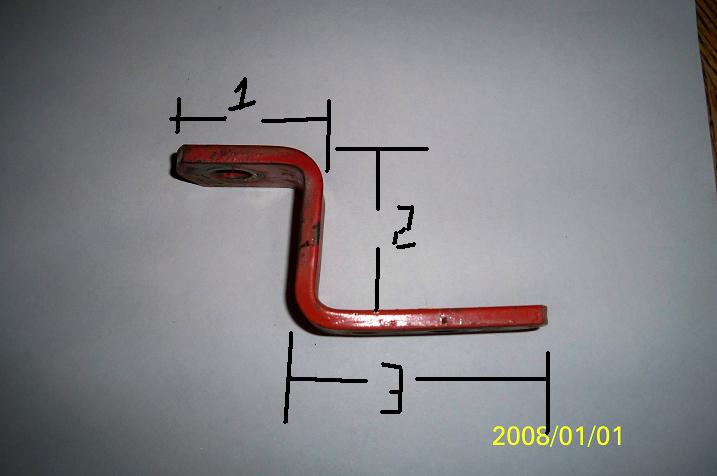

i have one i can measure for you ill go out to the shed after and get some pics to

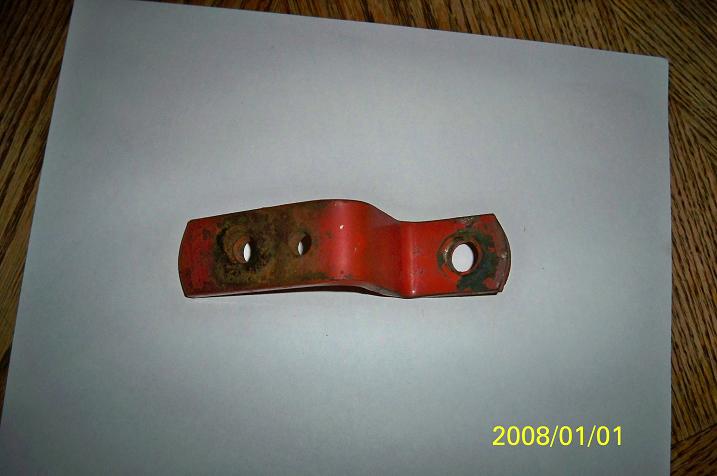

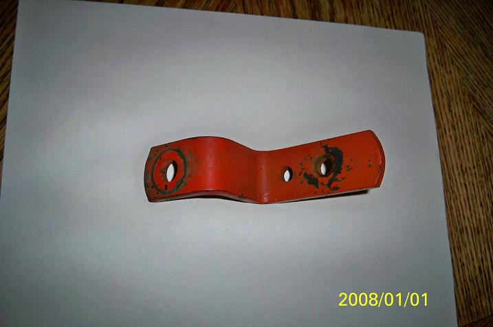

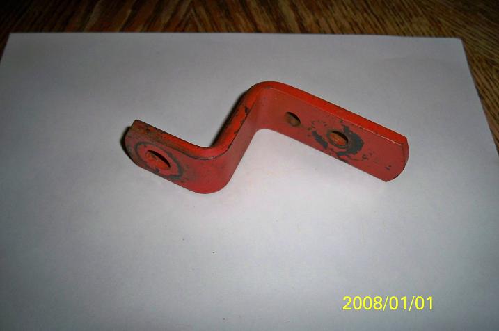

ok here it is if theirs anything im missing yell #1 is 2" #2 is 2" inside to outside #3 is 3 1/4 outside theirs three holes the two mounting holes are 7/16 and the light hole is 1/2 the pcs is 1 1/4 wide with the holes drill at 5/8 center the 1/2 hole is 3/4 cl from the end the first 7/16 hole is 1-5/16 from the end cl and the last is 2-5/16 from the end cl ( cl= center-line ) and the two 90 degree bends are just over 90
Posted - 06/12/2011 :  22:31:41  Show Profile  Visit Talntedmrgreen's Homepage Send Talntedmrgreen a Private Message  Reply with Quote
That's the seatpan mount for a tractor with no seatback (Simplicity). The one for the seatis for the B10, Big Ten, and B110, etc. It's great documentation of the bracket, but I think Chris is looking for the one that mounts to the seat bracket...it has a twist in it, to turn the bracket from vertical, to horizontal to hold the light upright.
