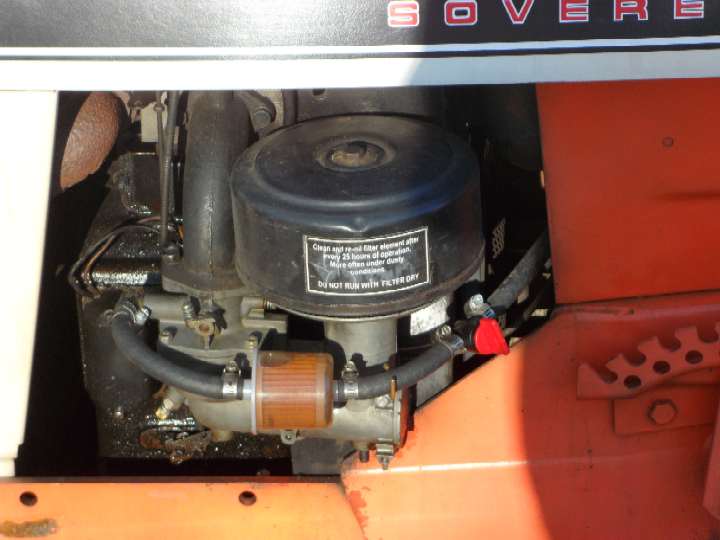

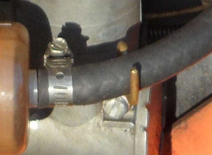

Hey Josh, I saw on your BIG TEN resto that you did just what I do with the fuel line. I've added a further refinement attaching a simple bracket made from a coat hanger using the top hole for mounting the choke cable on the outside of the carb. It always bugged me I couldn't get the line to stay perfectly level.

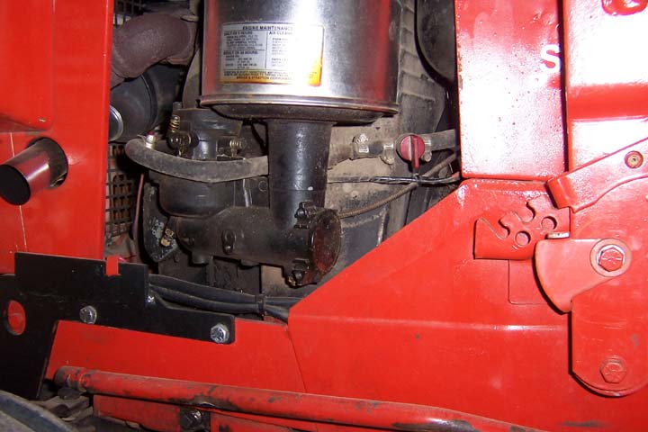

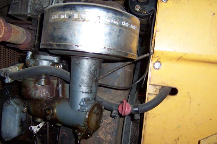

I like your line hanger but I use the old routing they used on the B-1 and B-10.

Yup, I've seen that and like it, but I like having a clear filter where I can keep a close eye on it

im with you larry on the filter ive put them on all the runners
Posted - 06/10/2011 :  22:09:57  Show Profile  Visit Talntedmrgreen's Homepage Send Talntedmrgreen a Private Message  Reply with Quote
The clear filter is a nice window to your fuel flow, when things go wrong. I've routed them various ways...never paid a whole lot of mind to it. I've noticed with a longer, droopy line, it pisses less fuel if you pop the line off the carb for maintenance. The flat line always drains iteslf, after the shutoff valve. (I have carbs on and off way too much as of late)
