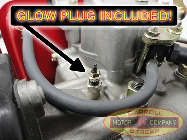

I noticed it had a glow plug. So I guess that if you buy it, you'll have to design your own glow plug controller since there is nothing connected to it.
Im having a tough time understanding why a glow plug would NOT be included....??????

I'm sure the above engine comes with the glow plug. You will need a small relay and momentary switch to energize it. Very simple to do.
