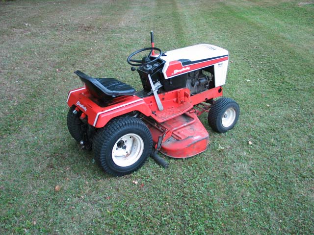

$300, 3 Long days, $150/parts - Battery, Drive belt, PTO belt, Fuel filter, Spark plug, Fluids.
Deck is ugly but solid, arbors are all tight and quiet. Came with 2 spare deck belts and no PTO belt
Still a few issues, missing deck adjustor (made a temp), Seems oil is leaking around breather tube (haven't looked yet), and something very strange. No, not me. Later on that

How high is the deck?
While wierd the only time I have adjusted mine is to move the rear rod that goes across deck and almost over the screws that hold the belt covers on. I have mine cranked up to get the deck as high as possible.

Well, that's working.
Is that the original blades, or new blades?
Do you do squares or diamonds also? I love those. You get interesting mixtures of the dark and light effects. Also prevents "grain" forming which happens with same directions all the time.
Another interesting thing is minimizing the overlap - it seems I am always studying how my deck actually performss, how it actually does what it does. I find the 2 sides require different minimal overlap - cos one side sucks air in, and discharge side blows air out - and the grass "leans" in the breeze. Drives me crazy, minimizing overlap, and avoiding "mohawks".
One time, at a golf course, I mowed a green, and mohawked the whole thing - had a nice chat with the superintendent about that one - recut this green and get it right - embarrassing, oops. Talk about infuriating golfers. (super fast green with little barriers all over it. oops)
Did you do a deck levelling also - probably you did, if you fixed the adjustor thingy.

The blades are the ones that came with it, They are narrower rhan my others but they are the right length and fit. Had to grind about a quarter inch off to get them sharp.
I like squares and diamonds, but I usually stripe straight, then 45 degrees left, then 45 degres right etc. I try to vary my patterns as much as possible. I only mow the big circle when I'm in a hurry.
I vary my overlap from 0 to 12 inches. I like 0, then my tires never run over the same place, always used to drive my right wheel down the former track left by the left.
I levelled the deck from side to side, more or less. The right side adjustor is froze, and I fixed the left side in place to match it. The front needs to be raised, it is level with the back. One nice thing about mowing back and forth is the left overlaps the left, right the right, and if the deck is a little off it doesn't show.
I only put the deck on to find if the arbors are OK, Now I know they are, I'll give it a good overhaul. With the near mint 48" deck on my Sovreign, it's not a high priority. This Landlord is going to become a dirt machine.
