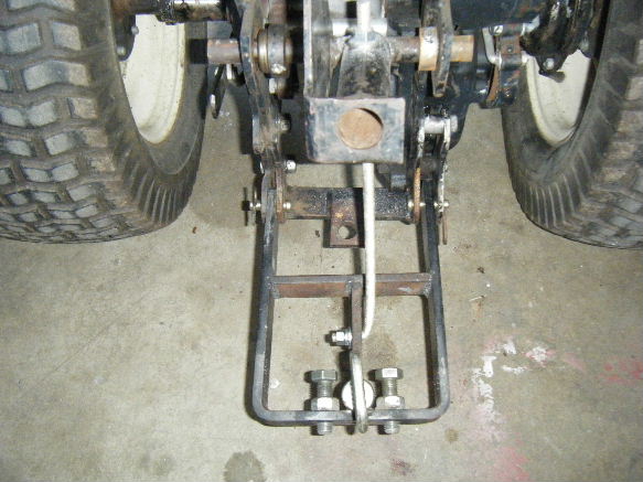

Okay what is the rod that goes into the rear lift called. I've seen guys put some kind of steel? rod in the rear lift to extend it further up and out. It appears to have a hole drilled through it. I've tried to find something that will fit, but haven't found anything so far. It seems to be very similar to the one on my Cub Cadet 1650 lift

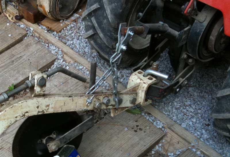

It's the bar/rod that goes into the lift over 1 inch in diameter, the big rusty looking hole in the picture. I've seen some 4-6 inches long and others over a foot with a chain

The original bar is about 8" overall. It is called a "plow lift pin" Go to the Simplicity web site and key in "990202". I made mine out of a steel stake for Diamond horseshoes.
