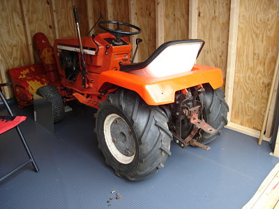

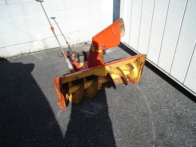

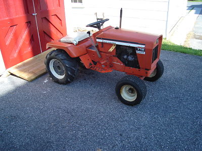

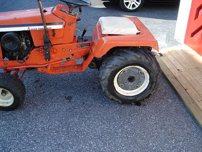

712 Shuttle. I bought this one for 3 main reasons: 1) the ags, 2) the lead weights (they are lead, not steel), and the snowblower.
I have to get used to the Shuttle. I keep forgetting that I have to use that thing under my right foot to stop, unlike the hydro where I never touch it.

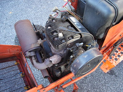

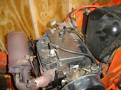

I have to make a shroud over the Kohler's cooling fins, looks like the PO lost the one that was there.
She'll get fresh oil and BGB fluid before I do anything with her.

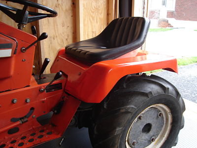

Ok, ditched the homemade "seat" and put a real seat on it:
Much better

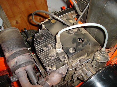

You were saying that a heat shield is missing... Did it look like the one my 716H has?
I had a fella tell me that 716H's didnt come with this heat shield but I bought mine from the original owner..
AC716H
213 Posts
Posted - 06/16/2010 :  17:08:13  Show Profile  Visit AC716H's Homepage Send AC716H a Private Message  Reply with Quote

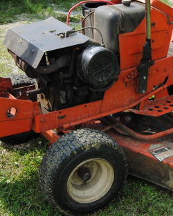

No, on this series the heat shield is a lot smaller. Here's the one I made up:
It's really not so much a shield, but designed to force the air past most of the cooling fin surface. The one I made up duplicates an original (seen here, on my 716H):
