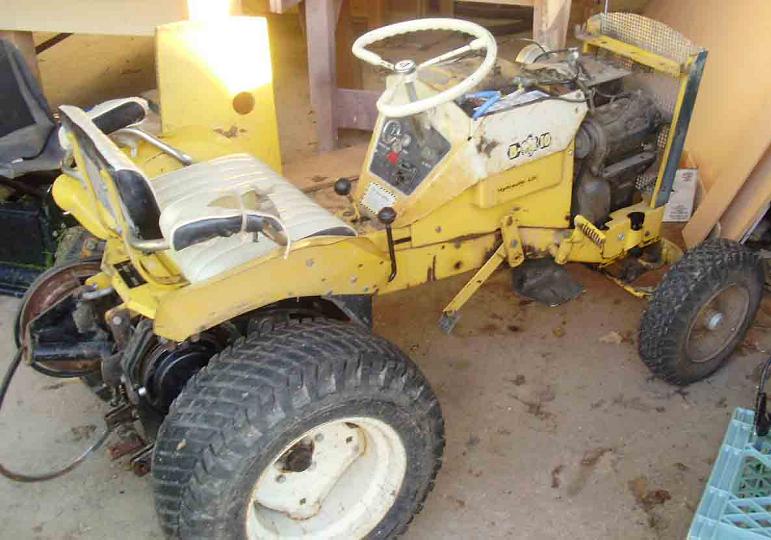

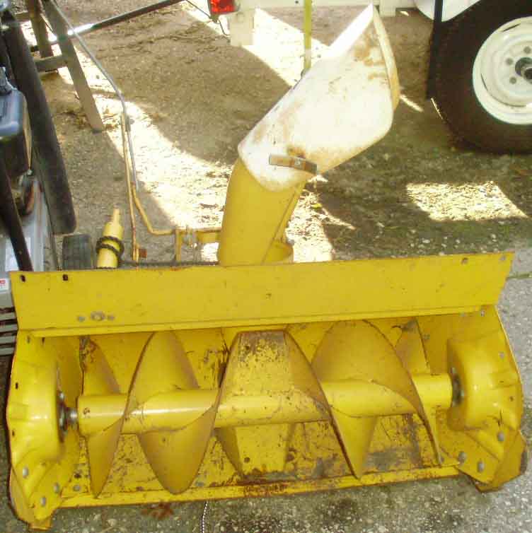

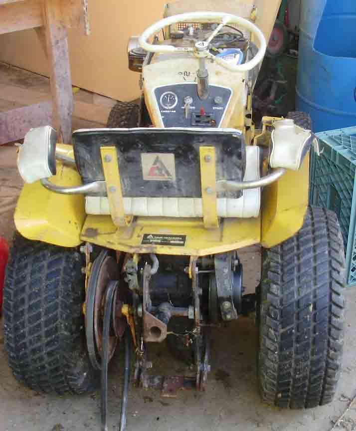

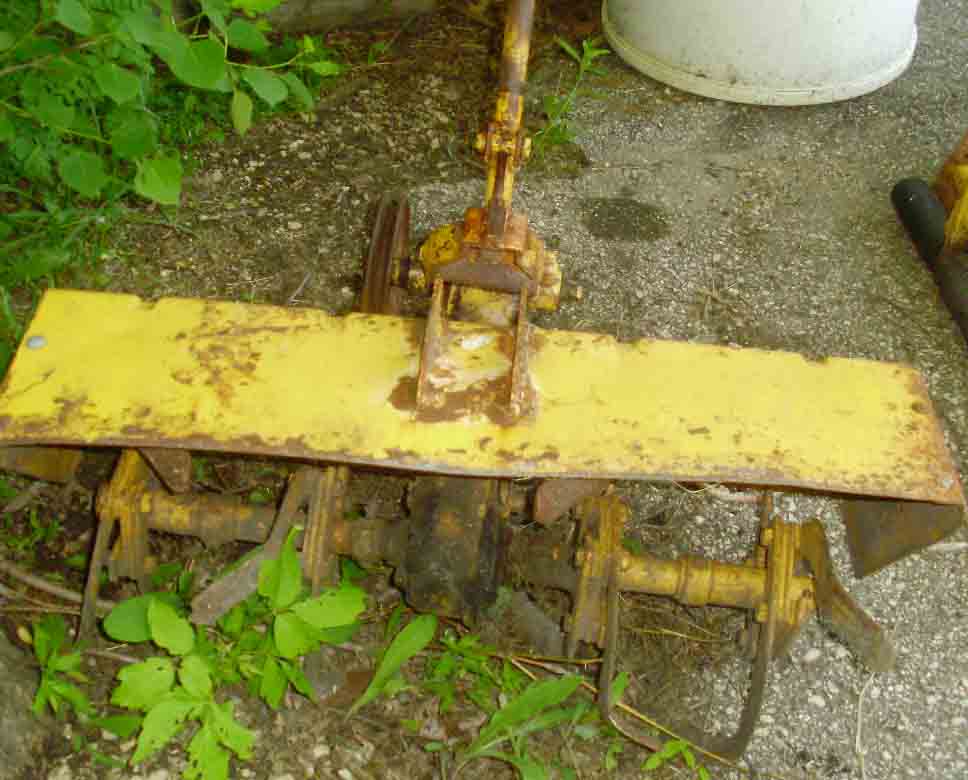

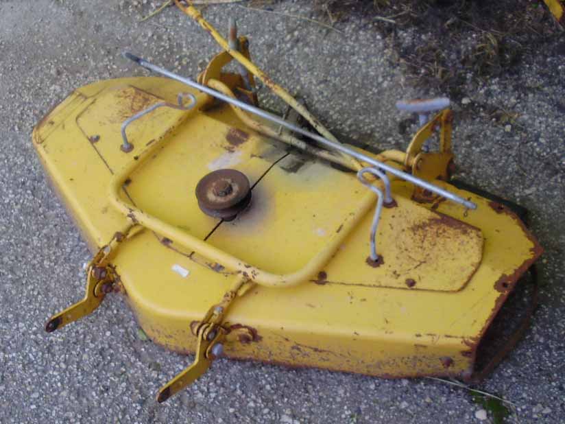

Took some pictures last night before the rian. Tractor came with the attachments. Mower deck needs a little bit of fixing but works. Tiller works great and the blower has only been used three times since bought with tractor.
