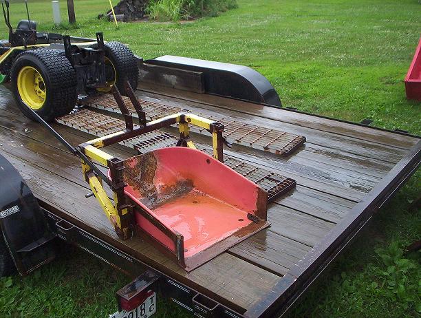

Ok Ill give this a try. If all you need is a johnny bucket I built this "Charlie bucket"(of Willy Wonka fame). It goes on three point hitch and I just lower it down to ground to relatch after dumping. I built it from a wheelbarrow and some old handrail. Well I have no idea how to post picture.

Sounds like a "Charlie Bucket" is exactly what I need. When I tried (and failed) to post a picture the problem was that I had spaces in the file name. For some reason only a simple form such as "picture.jpg" will work.

Wow that was a pain. Not a computer guy here. This is Charlie bucket.
Posted - 08/01/2009 :  20:43:43  Show Profile Send skunkhome a Private Message  Reply with Quote
That looks like the old slip scoops they used to pull behind a team of mules.
