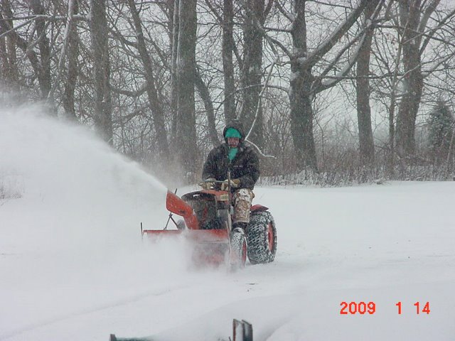

Beats the hell out of this !!
Burrrrrrrrrr! That photo made me rush to the bathroom.
BTW: quality looking work on that cab.
