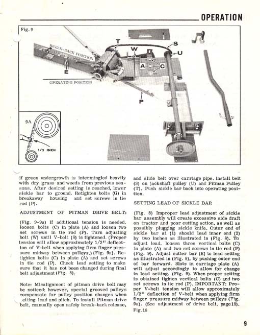

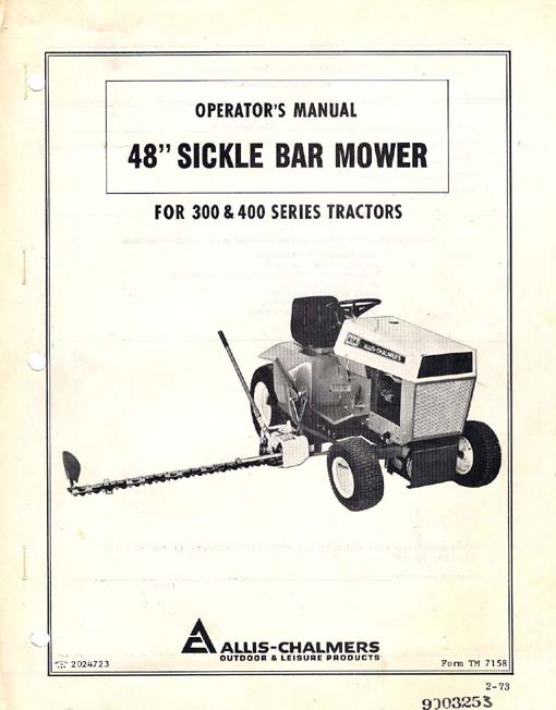

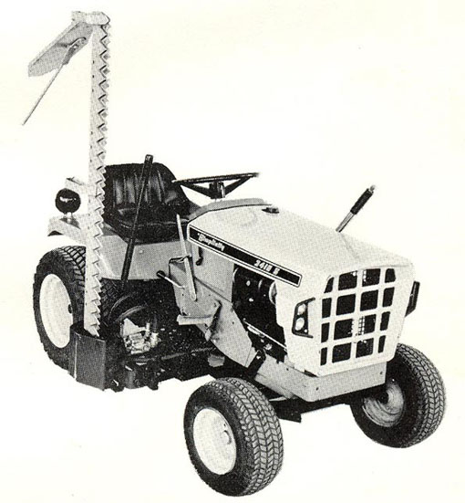

Mack Posted - 06/10/2010 : 07:51:53
Phil, I do not know if Simplicity manufactured their own sickle mowers or had another company make them. I do know the ones for the earlier tractors are a lot different than the one I have on this tractor, which was made by Haban Mfg. for the AC 300/400 series. I was referring to the earlier models in that instance. Just to make things clear as mud...
There is also this...

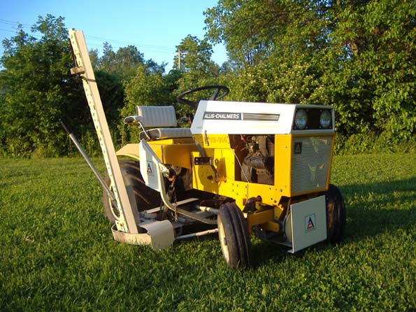

Originally posted by Mack
I have had AC/Simplicity sickle mowers in the past. I must say they are much lighter, easier to move around and mount onto the tractor than this Haban. From reading the manual, a little more complicated to get set up for mowing also. On the plus side, you run this three quarter to full throttle while mowing which should mean a nice cut. Also, it's heavy enough to warrant a dedicated tractor for it. :)

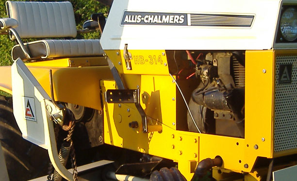

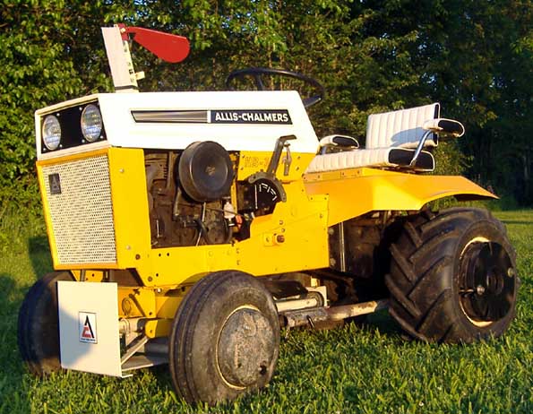

Mack Posted - 06/07/2010 : 23:12:54
Thanks for the comments. Got the final touches on the tractor today. Just need to clean up the front wheels and weights to be ready for the next show.
