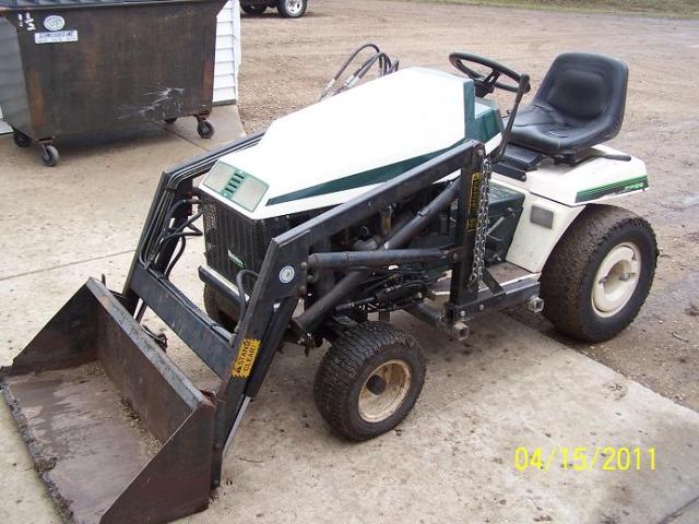

I have never enjoyed doing fiber glass work so finishing the hood
was something that was left till last. Every winter I say that I'm not going to do any painting till it's warm and dry and every winter I try
it again. Turned out better on this project than the Kubota G4200 but still has a long way to go.
First photo is the hood and scoop (air intake for the radiator) in the early stages. The next is in the finished stage.

Yes the brackets go forward and actually attach to the outside of the tractor brackets. I've looked at those things several times and they don't look right but they work like a charm.
The loader is a Johnson Work Horse. It's a clean looking loader but it doesn't have the self leveling bucket like my Kwik-way does.
When push comes to shove I'm keeping Johnson and selling the other.

Thanks for the pics, Chris, I know all you have to do is walk me thru this, but the front adjustable arms flip forward to the front mount, right? Initially i thought they were solid in that position. What kind of loader is that on the bolens, looks good. Thanks again,Dave. I got it all figgered out, thanks again

That looks great! However I think that loader would look better on my Allis! I bet it will be a real workhorse.
Cvans Posted - 04/16/2011 : 20:16:37
Daniel this Bolens must be quite a bit bigger than the Kubota as I can pick up the same weight without
all the ballast. Also the combination feels quite a bit more stable. It's been a long enjoyable project
and one I hope that will remain problem free.

Cvans Posted - 04/15/2011 : 22:38:37
Here is the Bolens ready to go out the door.
Out in the daylight.
And the air intake.
The pump mount
Next time I'll make make them bigger.
